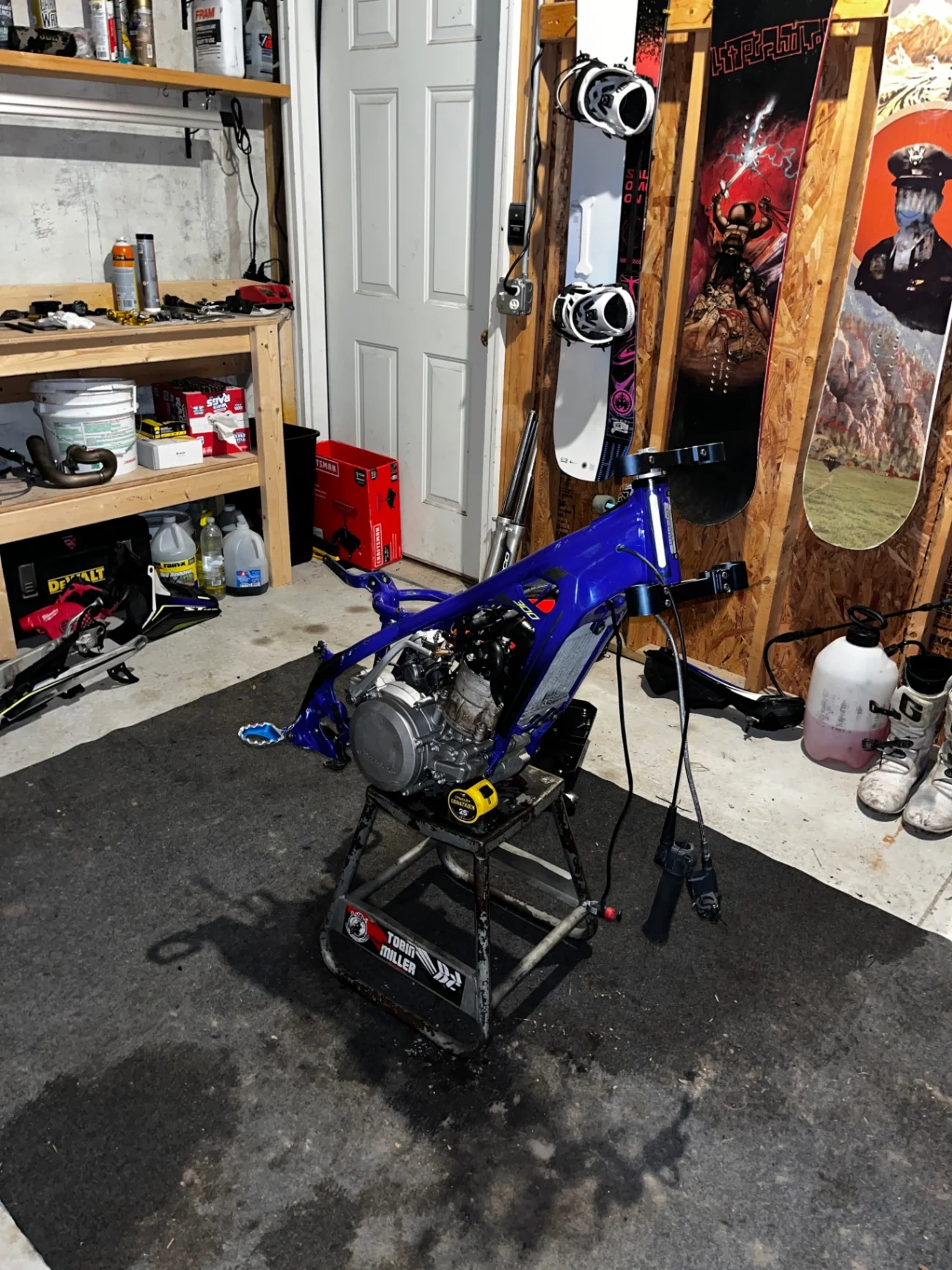

Turn out the fan was just a broken connector at the thermostat. Easy peasy, but still not sure about the leaky oil. I noticed that the drain plug did not have a copper crush washer. So I put a new one of those on and I’m hoping that does it. While I had it all torn apart I figured I might as well make the most of it so I did a nice little refresh. Bled all the fluids, repacked the muffler, and deep cleaned the engine. Stoked to go ride tomorrow!
